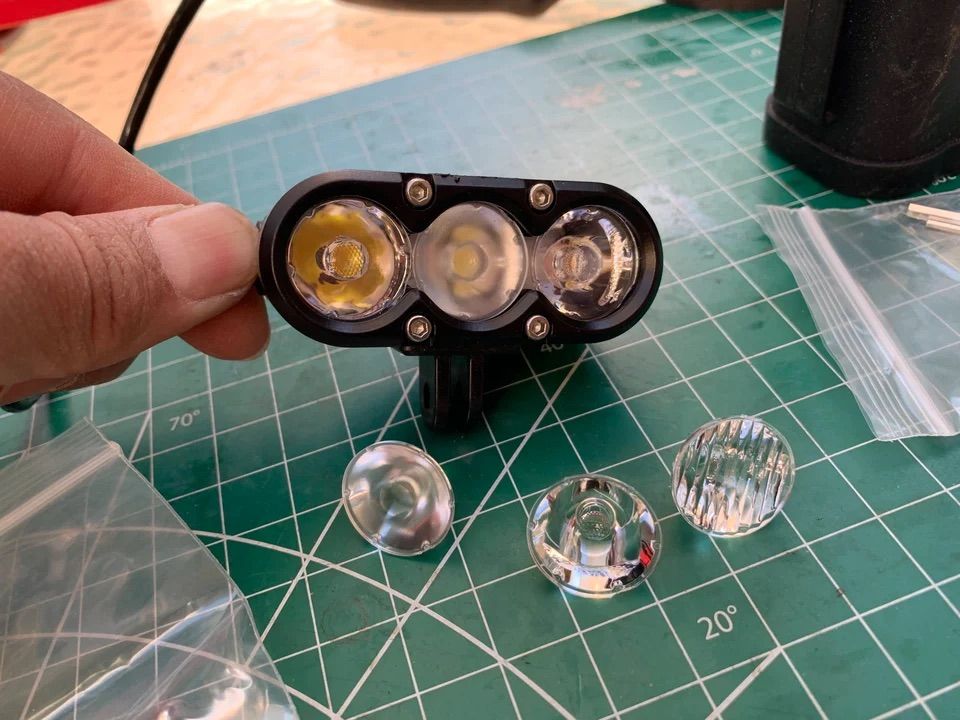

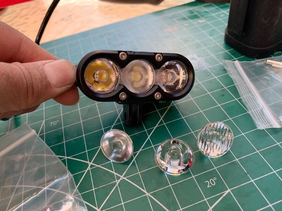

någon som har erfarenhet av gloworm..?
finns med tre leds, men intressantare sas värmehygieniskt är den med två. erbjuds där modeller 1700-2000 lumen med batteritid väl godkända 3,5-4h på max. fjärr på styret. har åtminstone tidigare funnits med varmare dioder.
en annan intressant feature är att som med bt40s kunna välja bland medföljande linser. bara att det finns fler:)
Laan84
Premium-hjälmlampa för skogen
Visa bilaga 514698
Det är en väldigt intressant feature! Måste kolla in..

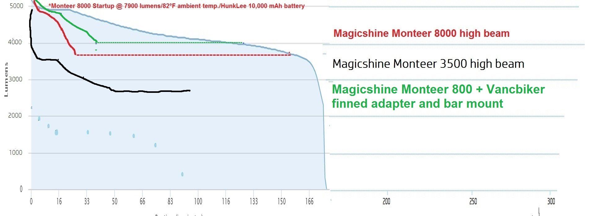

Inte själv nån erfarenhet,men stötte på denna text när jag skummade runt lite och letade lampor:
So it's a thrower and a very good one. Initial turn on lumen and max lux numbers are astounding but output degrades quite rapidly at first finally settling to a stable level about equal to a Gloworm XS after the first half hour. 108.5 gram lighthead weight is also similar to an XS so the Monteer is a ligit low cost competitor for the XS or any other high putput/high throw helmet light. As a bar light the Monteer 3500 is far less capable IMO. Beam is too narrow for my taste for MTB riding but OK for path/road use.
Efficient use of current
I did a little further testing pitting the Monteer 3500 against the Gloworm XS. I already knew both lights ended up fairly close in lumen output and max lux after about 30 min. when the Monteer's output quit degrading and stabilized. The plan was to also check current draw so I started the test with the Monteer hooked up to my digital multi-meter (since turning the light off to hook it up would reset the light to near startup levels) and after about 40 min. the Monteer's output had degraded to the point where it was about 10% less than what the XS was producing and the Monteer was drawing 2.73A compared to the XS drawing 4.15A (3.28 set @ 90% which almost exactly matched the Monteers output). So no surprise the XS wins @ output consistency (only about 3% loss in 30min.) but the Monteer seems to require less current to produce its lumens and should be able to eek a little extra runtime from a similar capacity battery.
Verkar vara värmestabil då den bara tappade 3% efter 30 min,riktigt bra!

tjusigt. har misstänkt starkt att monteer snart sänker sig ner till däromkring helt oavsett vilket lumen som anges.
en annan bra grej är att gloworm använder vanliga 8 volt med standardkontakt. lätt att ordna ersättningsackar framöver. dessutom har jag redan högkvalitativa 6-cells:)
de har ett lager inom eu varifrån man kan beställa.

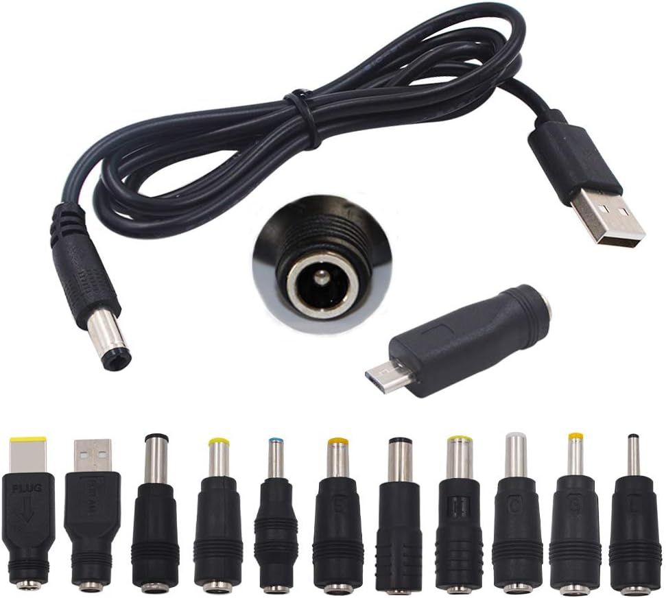

Vad betyder det?
När du skriver 8 volt menar du då två seriekopplade lithium-celler? Alltså med den spänning som vanligen benämn 7,4V?
Vad menar du med standardkontakt?
Även om man begränsar sig till runda tvåpoliga kontakter finns det en hel del att välja på
Det är bla därför det finns så många adaptrar särskilt för runda tvåpoliga kontakter
Om jag kommer ihåg rätt hade Magicshine åtminstone tidigare kontakter med 5,5mm ytterdiameter och 2,5mm inner

Jaa,som "tjatats" om är ju värmen en bov,oavsett prisklass och statusladdat märke.
Här ett annat testresultat,visar en Monteer 8000 som ger ca hälften in real life när värmen slagit till.
Dock är ju det möjligt att köpa en "billig Magicshine",t.ex Monteer 8000 och få 3600 äkta lumen ändå.....räcker och blir över helt klart.
Så jag köper kraftigare lampor än jag egentligen behöver,t.ex 4000 lumen blir kanske 18-2000 lumen i verkligheten när dom blivit varma.

kais01
Vad betyder det?
Men nästan lika vanlig är kontakten med 2,1 mm innerdiameter
Så vilken typ av kontakt är det Gloworm använder?
Och varför väljer du att kalla just den kontakten för standard?
ja;)
det är den kontakten som t ex erbjuds rakt av om man köper batteripackar från kaidomain.
