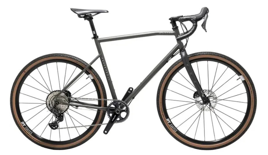

"Our ROADHOG forks have 45mm offset to keep handling swift, and forward right positioned disc mount for maximum axle security, "
