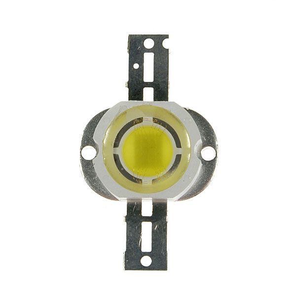

1)
- Input voltage: 18V~20V
- Total power consumption: 50W / 2.5A
- Output: 1700 Lumens Total (manufacturer rated)
sku_5766_1.jpg ht=600

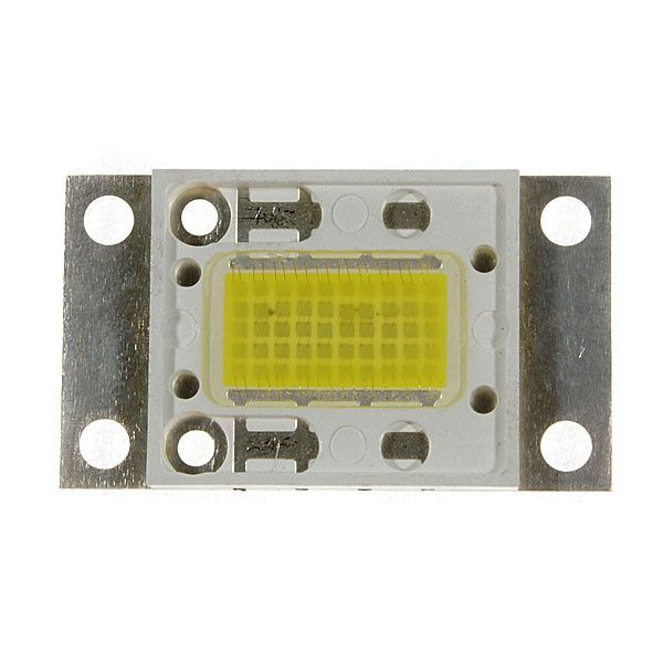

2)
-Input voltage: 18V~20V
- Total power consumption: 20W
- Output: 800 Lumens Total (manufacturer rated)
sku_5848_1.jpg ht=600

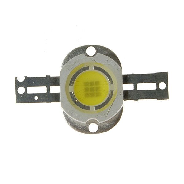

3)
- Input voltage: 11V~12V
- Total power consumption: 10W
- Output: 300 Lumens Total (manufacturer rated)
- Color temperature: 6500K White
sku_5876_1.jpg ht=600
Gissar att dom blir ganska varma.
