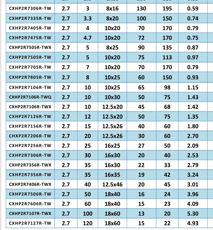

Those rim dynamos are normally for halogen lights, they put out a lot more power at higher speed as the ratio of big wheel drive small wheel spins it much faster. Most dynamo lights specifically state warranty void if you use them, worth checking.
The USB-Fahrradlader V3.1 capacitors are only 3F which means they have a high ESR. Why does this matter?...
If you look at the ESR rating for the 3F capacitors that is 180mOhm, max (but this is when new). X4 and you're at 720mOhm. Let's say they're charging or discharging at the median point at the maximum endurance current of 0.59A, W=IR^2 = 0.3W loss. This loss is heat, which is a capacitors life-span enemy. They will wear quickly, this increases the ESR and the effect worsens. Similarly for discharging at the medium point of 7.5V they can only supply 4.425W as a safe maximum, far less then what a dynamo hub can provide (for a dynamo hub it's under 20km/h). Ultimately after a relatively short period the super-capacitors won't be able to charge or discharge at meaningful current as the ESR will already be much higher then the new maximum.
As a comparison with the Igaro S1/C1, they use 2 x 120F capacitors. If you look at the chart the max ESR is 22mOhm and a safe current of 4.93A. That's 44mOhm v 720mOhm or a 1600% improvement. They are large enough to sink any current the dynamo can provide without any meaningful change to the internal temperature. The lifespan when capacitor heat is controlled is exponential, not just 1600%, but far greater.
As the saying goes buy cheap buy twice. :)

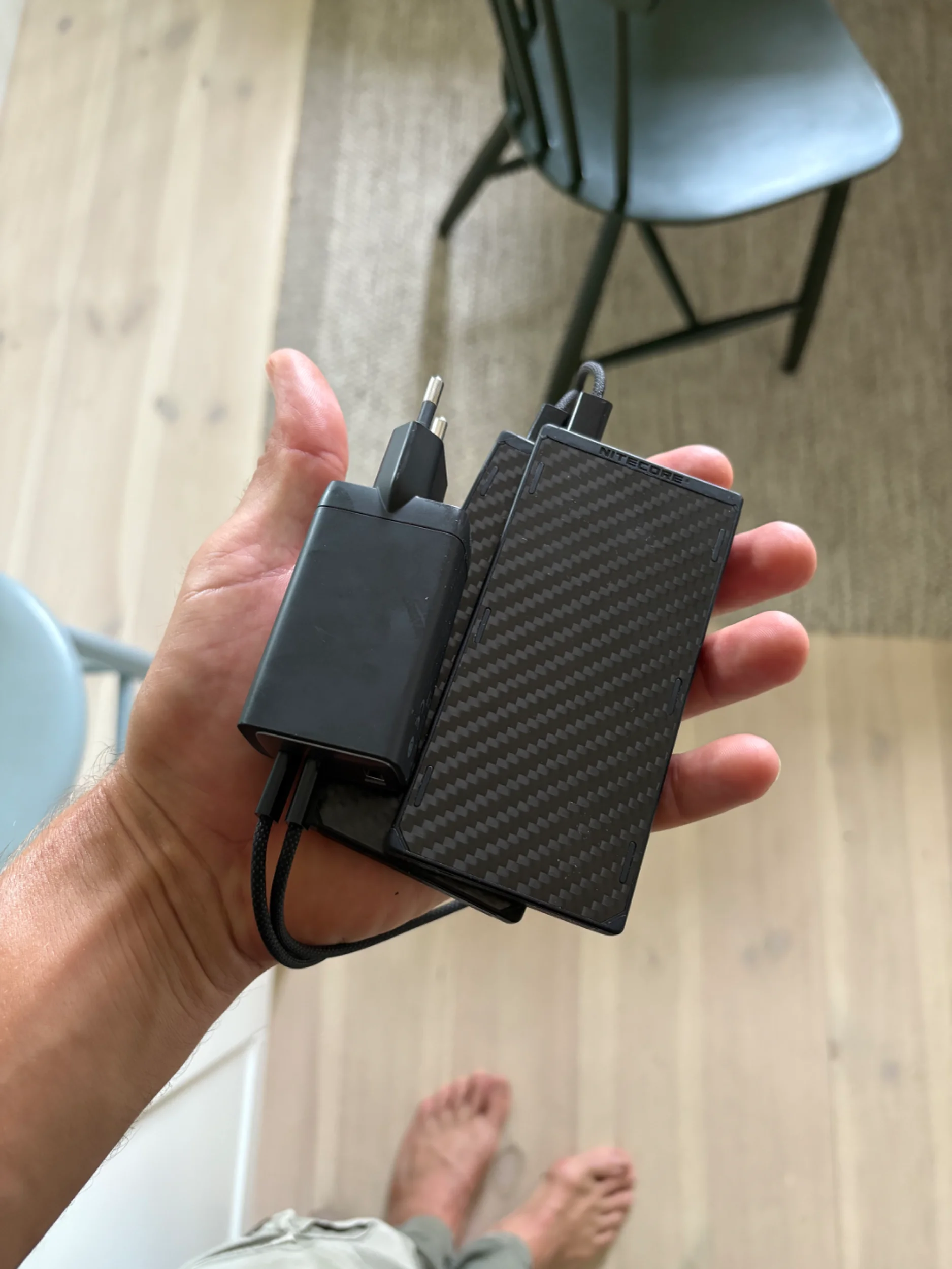

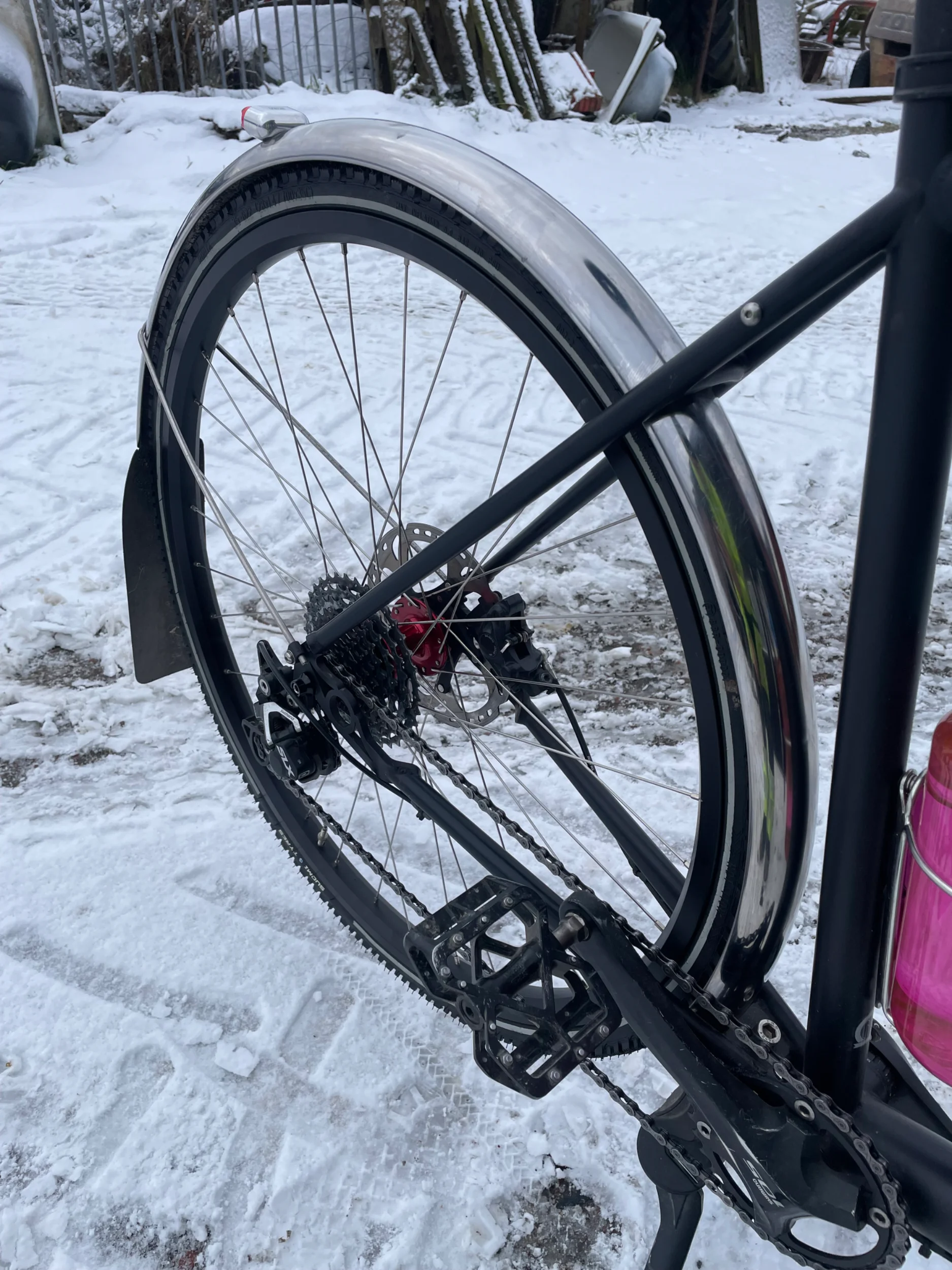

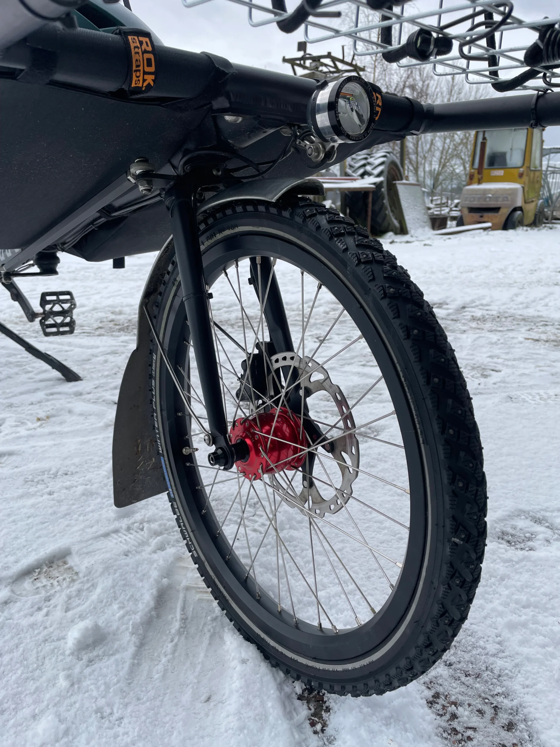

Lite input kring navdynamo från mina en bit över tio års erfarenhet:
Köp rätt grejer direkt. SON är evighetsprodukter. Förutom om man skaver av en kabel (jag fäste en kabel dåligt inuti bakskärmen på en cykel som därmed nuddade däcket och tillslut skavdes av). Kvalitetskänslan är på en helt annan nivå - med väldigt goda möjligheter att montera allt snyggt och prydligt.
Trots flera cyklar med navdynamo har jag aldrig fått tummen ur att skaffa laddare. Förr var jag sugen men alla lösningar verkade dåliga på ett eller annat sätt. Numer har vi hamnat i ett läge där laddningen av powerbanks går så ruggigt fort, de flesta elgrejer man har med sig har USB-C och går att snabbladda. 1 timme på pizzeria ger flera dagars möjlighet att ladda på nytt, om man inte har väldigt hög strömförbrukning av någon anledning.
Det största problemet (på de dyra, bra lösningarna) med att ta ut el för laddning verkar vara att det alltid någonstans finns en kontakt som är dåligt vattenskyddad. I verkligheten verkar det vara så att man får lägga en kabelhärva i en väska som är tät, men ändå har en genomföring för kabel (som inte kommer vara tät). Kommer ju garanterat fungera ett tag, men lösa kablar och annat har en tendens att inte bli så långvariga imho. Alternativet med att ha en kontakt på styrröret kan jag inte förstå hur det fungerar över tid öht. Vatten och skit i en USB-kontakt kan aldrig fungera tänker jag...
Så, för min del är dynamobelysningen uteslutande till för pendling eller allmän transportcykling. På långcykling kör jag batterilösning. Jag har en kombo av två 10 000-powerbanker med snabbladdning och en laddare som klarar att ladda båda samtidigt. De kan dessutom i sin tur snabbladda telefon och annat, och i praktiken lägger jag väldigt lite tid på att passa laddning och annat utan laddar powerbankarna vid behov utefter vägen och elektroniken i tältet på morgonen/kvällen.
Ska sägas att jag använder telefonen typ ingenting på äventyr, varpå den håller i många dagar (om den ens är påslagen). Vid vandring loggar jag inte ens någonting och då försvinner gps, radar och belysning förutom en pannlampa som knappt ens används ändå. Har närapå noll laddångest numer.
Två Nitecore-powerbanker som är skitlätta, en Anker-laddare (som kunde varit lite mindre) och två kvalitetskablar, så klarar jag mig väldigt länge!
Sen ska också sägas att navdynamon och belysningen har orubbliga platser i mitt cykelstall. Lastcykeln som används varje dag och snabbpendlarcykeln/randoiregncykeln har full uppsättning med fint installerade belysningssystem. Helt otänkbart att behöva hålla koll på laddning av lampor på cyklar man använder som vardagsfordon när man väl vant sig.
Likadana system på båda vardagsfordonen. Kanske inte världens tydligaste bilder, men det var dom jag hittade.. Speciellt baklampan från SON med standlight och för skärmmontage är galet tjusig och funkis imho!
Sammanfattning: Navdynamobelysning för pendling och vardag, snabba powerbanks för äventyr är vad jag kört och varit nöjd med.
Edit: Ser nu att man inte ens ser framlampan på Genesisen, men det här blev mycket längre än vad jag tänkt och nu pallar jag inte leta bilder mer.🤪
