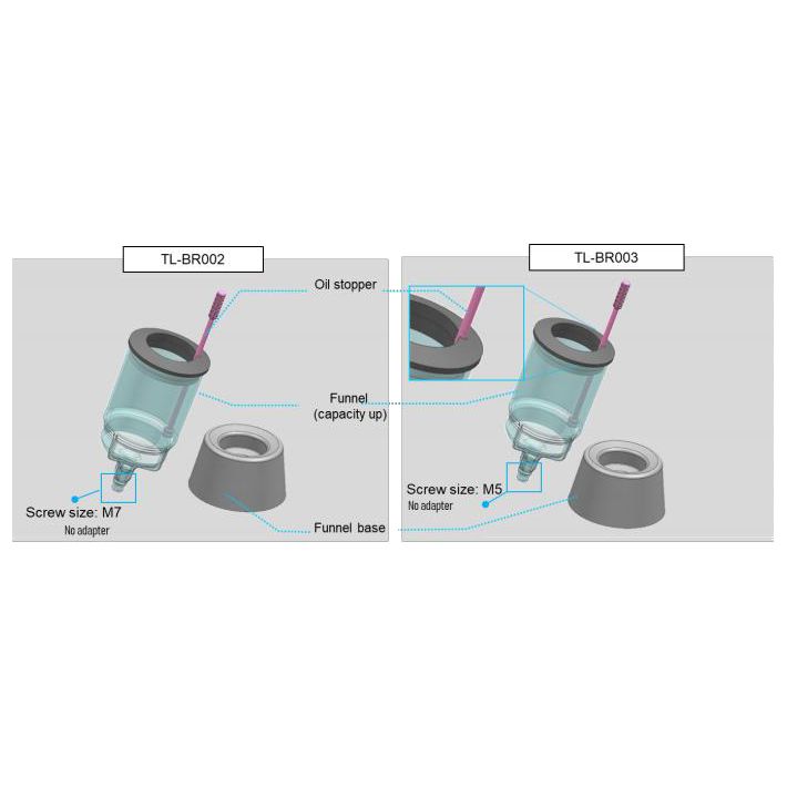

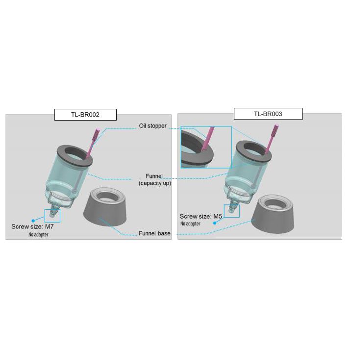

Toppen, tack för svar! Jag frågade tidigare butik vilken kopp jag skall ha, men ännu inget svar. Kanske ni vet?
“I would be much obliged if you could please advice which of Shimano’s bleeding funnel with oil stopper that fits Shimano 105 ST R7020 STI; is it TL-BR002 or TL-BR003? Put differently, is the screw size M7 or M5? It is not even mentioned in the dealer’s manual.”
