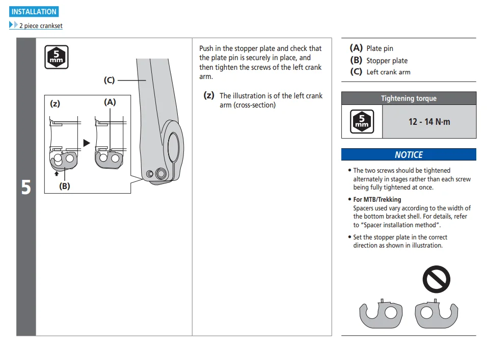

Högre än jag trodde om inte gemini ljuger för mig
Torque: 12-14 Nm.
Method: Tighten these two screws alternately in stages, not fully tightening one before the other.
Re-check: After approximately 100 km of riding, re-check these screws for tightness with a torque wrench.
Torque: 12-14 Nm.
Ja, 12-14 Nm verkar stämma. Detta enl. Shimanos Dealer's Manual (s. 15).
