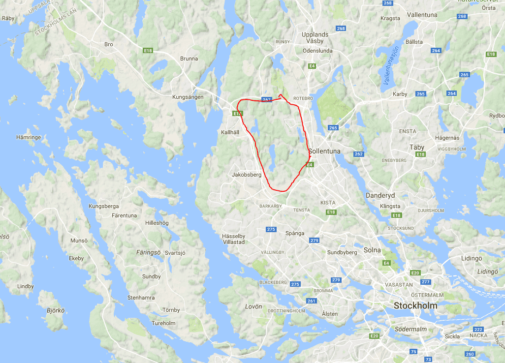

Generally, I would say that taking the commuter train to get out at least 20 kilometers, or preferably a bit more, from central Stockohlm will help you avoid some navigation problems if you ride by yourself. Also, the first part when riding out from central Stockholm is not much fun from a cycling persepctive.
There is a schematic map of the commuter train lines on https://sl.se/ficktid/karta/vinter/Ptag.pdf For the northern lines, I would recommand going at least to Sollentuna or Barkarby (depending on which line you chose). Then you can ride up over Järvafältet (the red-marked area) and continue to the north.
Or, perhaps even better, go to Kungsängen or Upplands Väsby where you will be out in the countryside for real within a few kilometers from the train stations.
