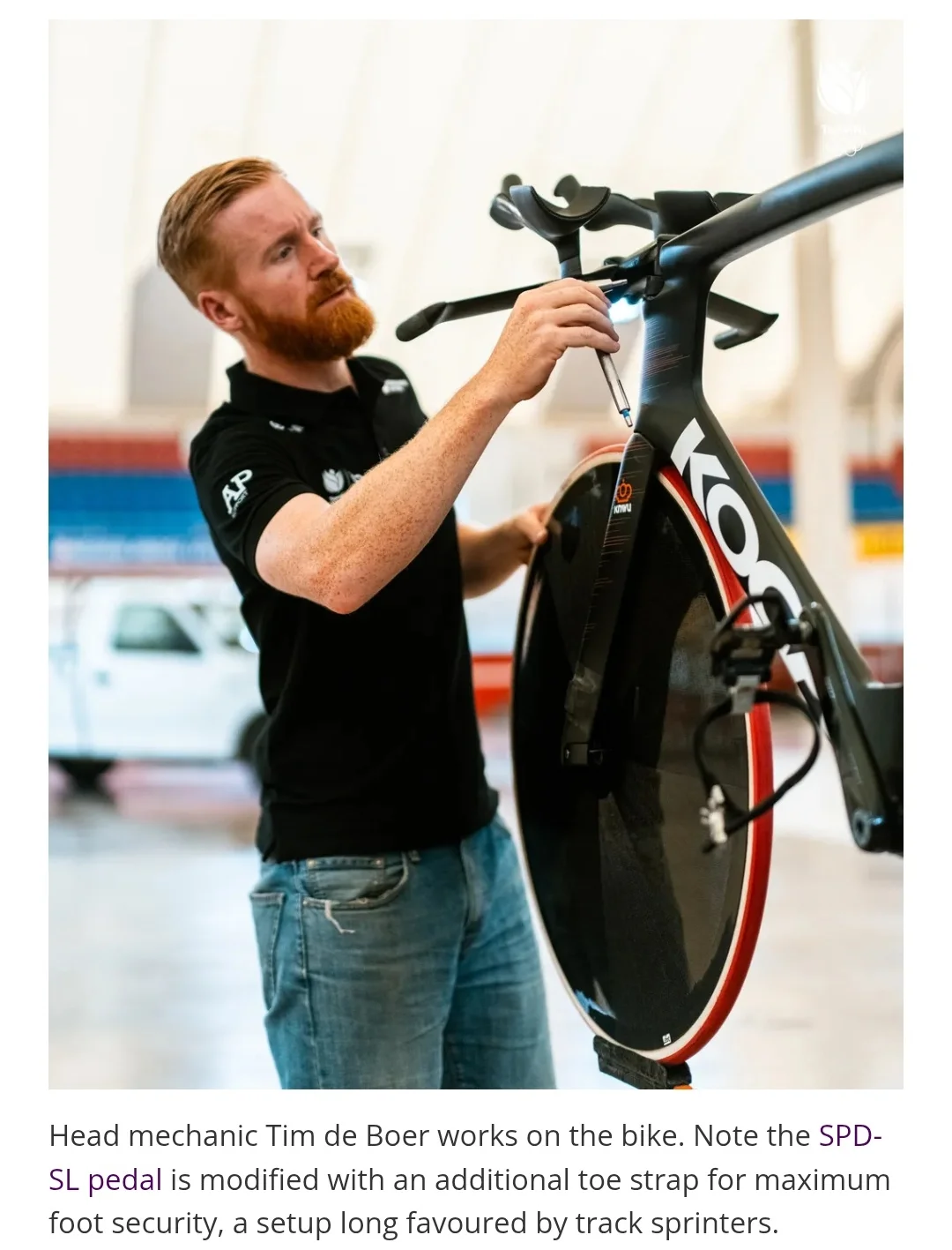

Jeffrey använder SPD-SL. Och remmar.
Från https://www.cyclingnews.com/news/je...eck-the-world-record-holders-koga-track-bike/
