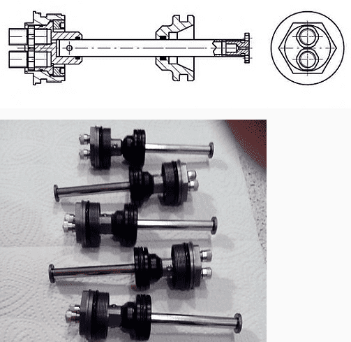

Hittade detta: http://forums.mtbr.com/all-mountain/my-canyon-strive-al-991800.html om att nån tysk hobbypulare har gjort en konvertering där man byter ut tokens och topcap i sin Pike mot en till luftkammare! Verkar intressant, A+ för effort som man säger.
Tysken kallar det "AWK doppelkammersystem", http://www.mtb-news.de/forum/t/awk-doppelkammersystem.728967/ .

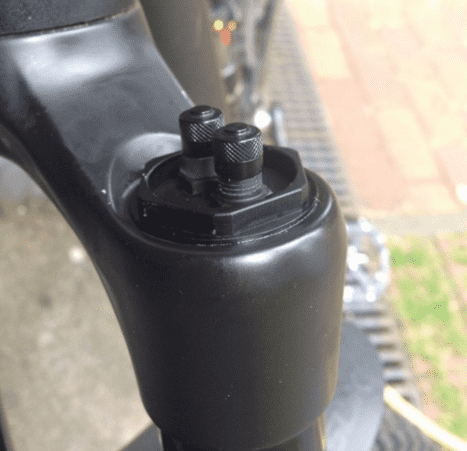

Du glömde det intressanta! ;)
"This is probably the most exciting mod.
a german hobbyist made a topcap replacement for the Pike.
its a piston on a rod which replaces the tokens and creates a second high pressure air chamber.
i can now control ramp by air pressure on that upper chamber and significantly reduce the pressure in the main chamber.
This prevents the fork from sagging mid travel even on steep technical decents while running less pressure than usual, which make it a lot more responsive on small hits.
sounds too good to be true but isnt.
one valve fills the main air chamber, one fills the so called AWK (AusWeichKammer or Squeeze chamber)
the length of the AWK travel is just short enough to prevent collision of the internal parts when bottomed out.
