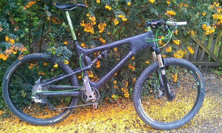

Gött, lite inspiration!
Inte speciellt snygg, men...
http://bike-related-projects-and-antics.blogspot.se/
