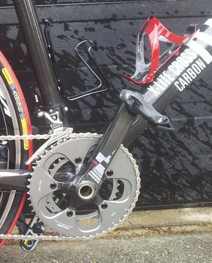

I think I need a new chanring for my SRAM Red crankset, the large one. The one I got is called SRAM powerglide 50/34T and although the crankset is SRAM Red the front and rear derailleur is Force with a 10-speed cassette. I can’t really find exactly the one I got so any recommendations?
    154.1 KB · Besök: 52

Sabbath: We do not have the chainring in stock at the moment, neither has our distributor. But we can order it anyway and the estimated delivery time to our warehouse in Gremany is June 1st. The price is approximately 930 SEK. Please let me know your customer number in case you want to order the chainring.
/Mats Ribacka, ROSE
