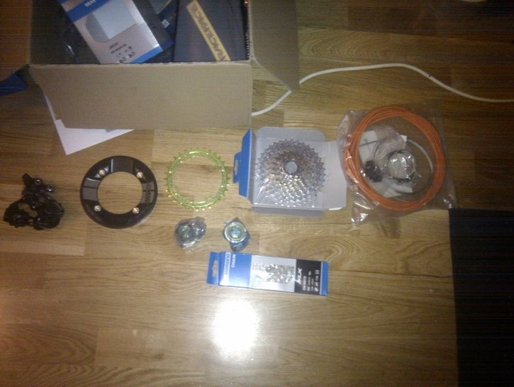

I väntan på att ramen dyker upp.
Zee bakväxel.
Raceface N/W.
Truvativ bash
SLX kedja + Kasett.

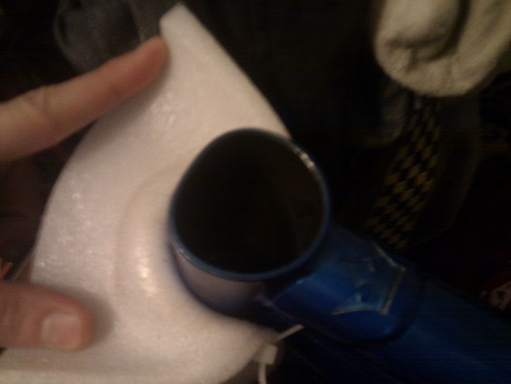

Fd. Byggtråd. Problemen med Stanton är lösta tillfredställande.
Jahapp. Nu har jag fått svar från stanton om en möjlig lösning. Jag är inte nöjd.
Hey Mattias
It's a shame to hear about you're frame.
The frame was sent with a totally round head tube, the quality control of Reynolds UK would not allow a head tube to be shipped to the manufacturer in that state.
Also the quality control of the factory would have not aloud the frame to be shipped to me in this state and I personally inspected your frame and packed it myself
as I do with all the frames with my name on it.
As you have signed to say the good you've received were in good condition we're in a bit of a quandary as I'm unable to claim the damages caused by the curriers
against my insurance. I do have a tool for fixing this issue as I've experienced this damage caused by poor handling through curriers before (and I like making tools).
The only option I can suggest that involves us is that you send the frame back and we do our upmost to fix the frame for you.
Thank you
Dan
[/quote}
Hur kan jag gå vidare på ett bra sätt. Lösningen känns inte alls som en bra lösning.

Tycker fortfarande du ska reklamera hos speditören, transportskadan syntes ju inte utanpå paketet. Alternativt så har den varit för dåligt packad om nu Dan har packat den själv och den har kunnat bli skadad utan att det ens syns på paketet.
