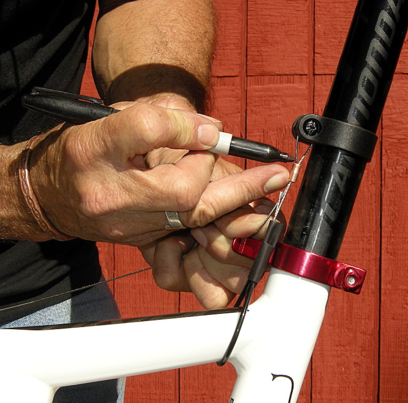

Något för petri kanske?
Tech Tuesday – Make a Ghetto Dropper Post
http://www.pinkbike.com/news/Tech-Tuesday--Make-a-Ghetto-Dropper-Post.html
