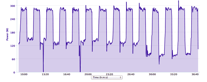

14 x 1+1min @ 4.3 watt/kg (power2max)
    16.8 KB · Besök: 33
