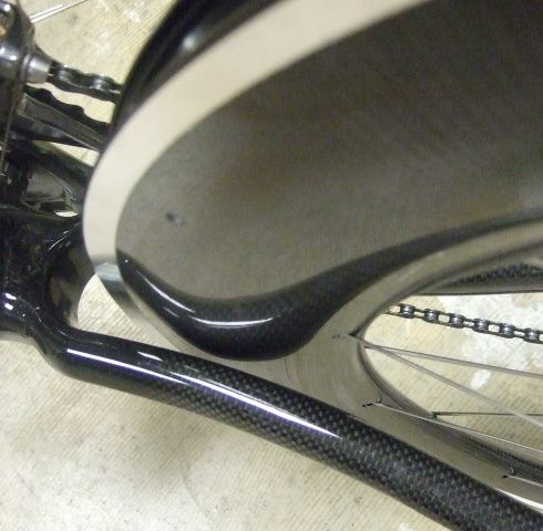

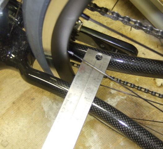

Direkt från HED:
"This is the best way to see where the issue is.. we do have a cardboard cut out that is a little more hands on.. but another issue is frame flex.. felts are really bad for fat americans as are P4s.. wimpy rear stays allow for wheel movement and rubbing.
This frame has about 40mm of clearance between the stays. frames with 35mm or less at their narrowest (pic shown where measured) may have issues with the C2 90mm rim."
